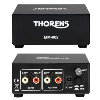

MM002 포노앰프
Mode - Moving Magnet (MM)
Gain at 1 kHz - 40 dB
Cartridge matching (input impedance) - 47 kOhms + 220 pF fixed
Frequency response - 10 Hz - 50 kHz (-3 dB) - ±0.3 dB max.
RIAA curve accuracy - ±0.3 dB max.
THD+N - <0.015%
Signal-to-noise-ratio - >86 dB
Crosstalk - ≧40 dB
Input sensitivity - 3.14 mVrms for -10 dBV output (316 mVrms)
Max. output voltage - 498 mVrms at 5 mVrms input (1 kHz)
Output impedance - 47 Ohms
Input connections - 1 pair of RCA sockets (left/right)
Output connections - 1 pair of RCA sockets (left/right)
Power supply - 24 V DC / 630 mA
Power consumption - 3.3 W / 15 mA
Weight - 292 g (not including power supply)
Dimensions (W x H x D) - 100 x 45 x 93 mm
